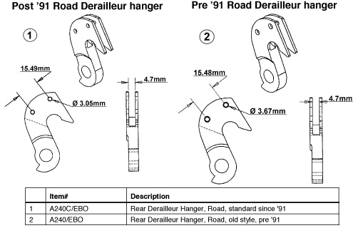

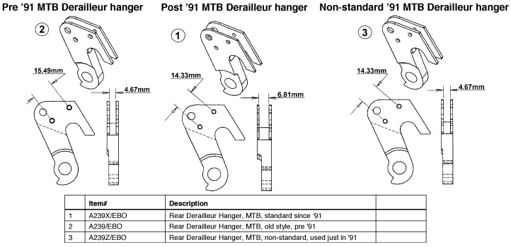

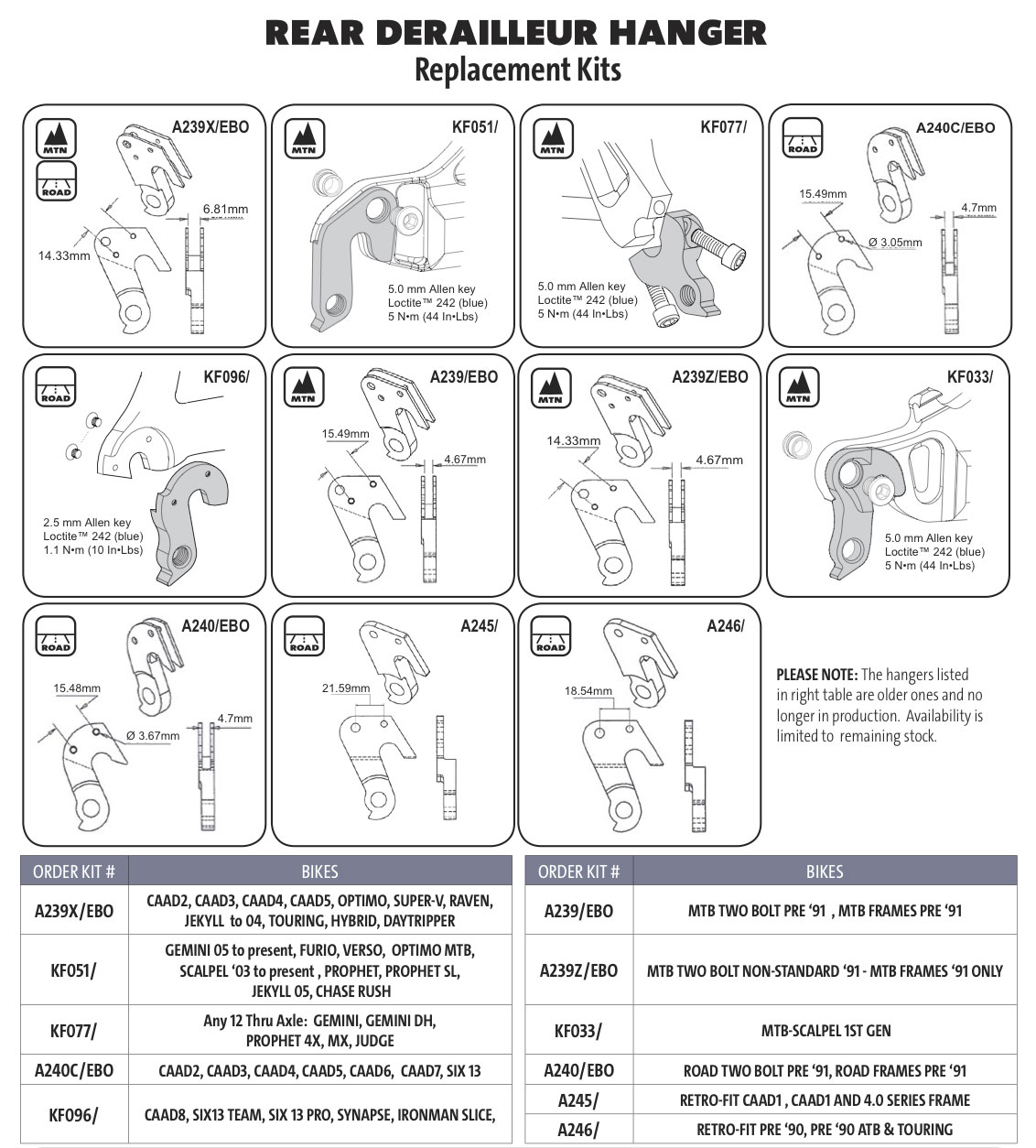

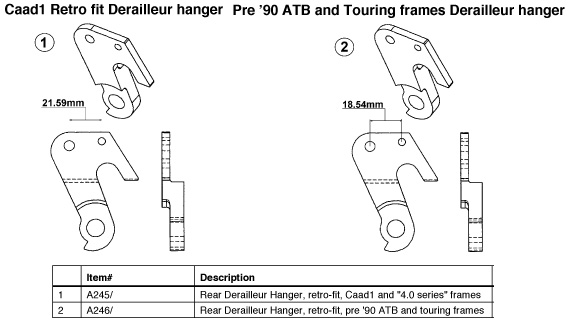

1984 SM500 Restoration
(PDF) From the Cannondale website
To purchase a Cannondale Hanger, Take the (order kit #) to any cannondale dealer. Vintage Cannondale and Cannondale.com do not sell Hangers. Only a Canondale dealer.

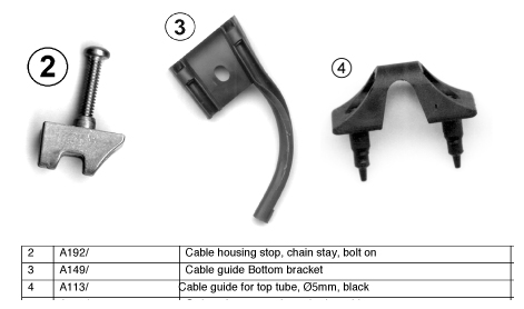

Cable guides:
(update 2011: Cable guide #4/A113 is no longer made by Cannondale)
For Temp stick on guides (3 pack) can be used:
PDF version
